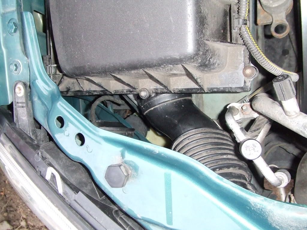

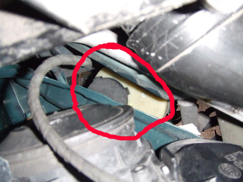

    I come home, only to open the bonnet & find this!!
    who on earth decided that this was the best place to put the rsevoir??

    Its gone dark on me now but was wondering, theres a green panel showing just below the airbox, now if that was detachable, then possibly more access???
