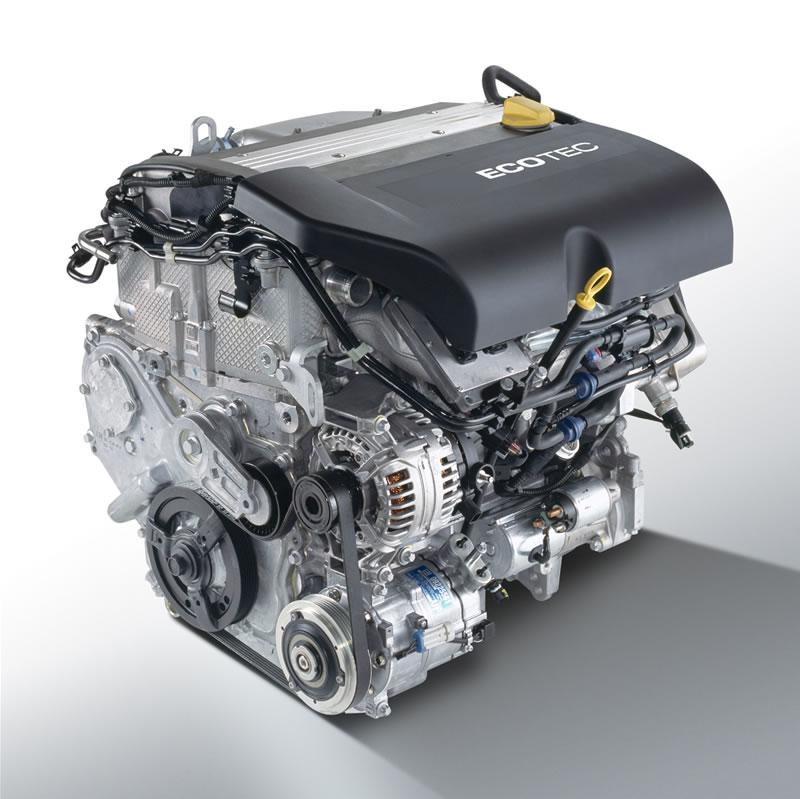

    No, I don't know why you'd want to look at a picture of the 2.0T engine, but here it is anyway. Avert your eyes if you find it excessively superfluous.
    Engine Specification
    Engine, location
    Front, transverse in front of axle, 10° backward inclined
    Cooling system
    Liquid, sealed circuit
    Cylinders, number
    4
    Bore (mm)
    86
    Stroke (mm)
    86
    Displacement (cc)
    1998
    Compression ratio
    9.5 : 1
    Engine, type
    In line; 5 main bearings
    Cylinder block/ head material
    Aluminium/ aluminium
    Camshaft(s), location
    2 overhead (DOHC), driven by chain
    Valve train
    Roller rocker with hydraulic bucket tappets
    Valve, arrangement
    v; 4 per cylinder
    Valve, adjustment
    Automatic - hydraulic
    Fuel system
    Sequential multi point fuel injection
    Ignition system
    Electronic ignition map, ignition coil direct to spark plug
    Fuel pump
    Electric, in tank
    Emission control system
    3 - way cat. conv. with 2 oxygen sensors
    Output (kW/hp CEE at 1/min)
    129 / 175 at 5500
    Specific power (kW/l; hp/l)
    64.6; 87.6
    Max. torque (Nm at 1/min)
    265 at 2500
    Specific torque (Nm/litre)
    132.6
    Mean effective pressure at max. power/ max. torque (Nm/litre)
    1408.7/ 1667.5
    Average piston speed (m/s)
    15.8
    Engine oil, capacity (l)
    6
    Cooling capacity (l)
    7.5
    Battery 12V, capacity (Ah)
    66
    Alternator 14.2V, capacity (W)
    1704
    Max. service interval
    20,000 miles or 2 years
    Emission compliance
    Euro 4
