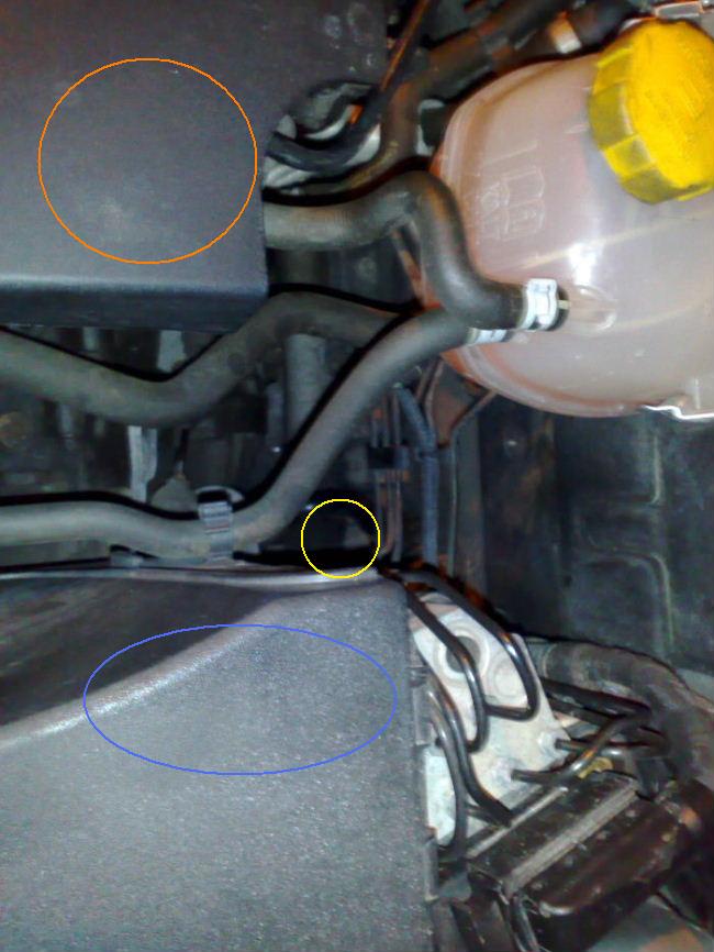

    sorry it taken so long to get back to u m8. but all i did was put the car on axle stands and removed the wheelslike i say u will need someone to hold the flat on the driver side tie rod to stop the steering rack from twisting.will try get a picture for you.if this is any help if u look at the wheel hub from the passenger side the parts u are looking at are at the right hand side of the wheel hub and the tie rod is the long pole like part that goes towards the engine.if u look from above the engine down past the abs module you can see the part and the gaiter protecting it from road grime. this veiw is the best point at which u should attack the part at as this route offers more leverage of the adjustable spanner. but it still ****** tight tho.

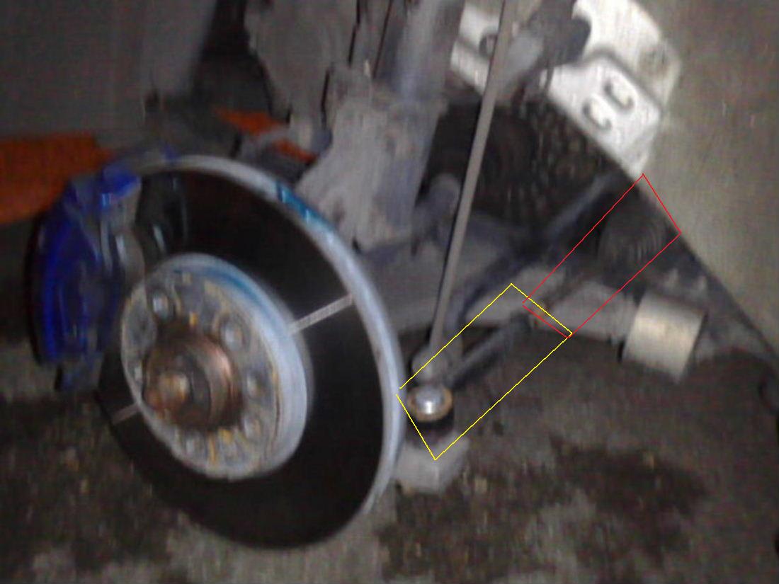

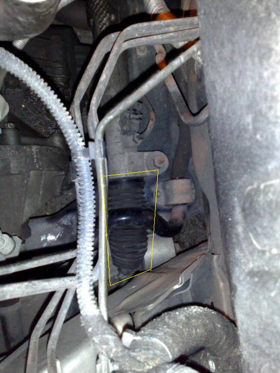

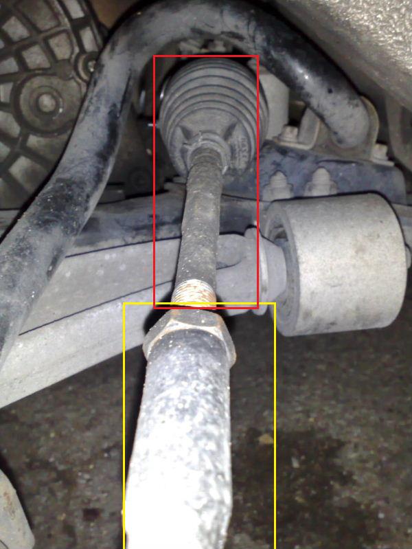

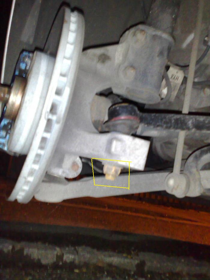

    right then m8 i have just been out in the freezing cold for these so bl00dy better be worth it lol the pics not in order sorry m8 but easy to make sense of.
    below in the yellow box is the track rod end in the red box this is the tie rod and the gaitor which protects the ball joint. before u remove the track rod end loosen the nut on the end of the track rod end shown in this picture cause it is a right ***** to remove when the track rod end is off.
    next track rod end in yellow and tie rod in red.
    image below shows u the track rod end bolt which needs to be taken off then knocked upwards out of the hub to remove.
    below is a close up of the gaitor from above the engine.
    below is above engine bay yellow circle shows the tierods position, blue marker shows battery cover and orange shows the engine cover.
