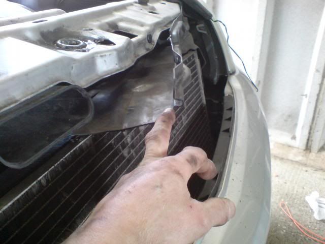

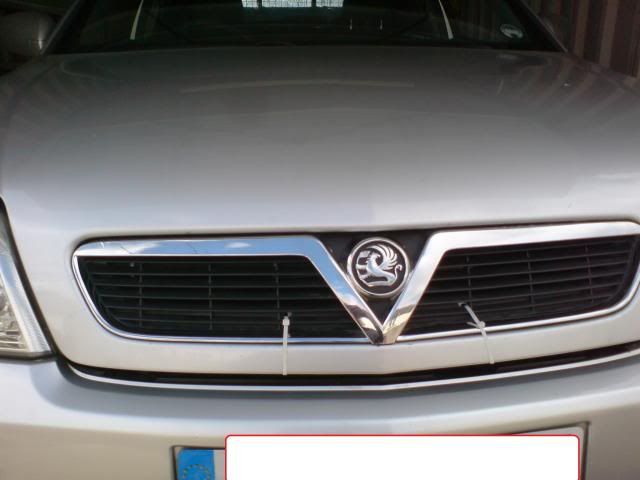

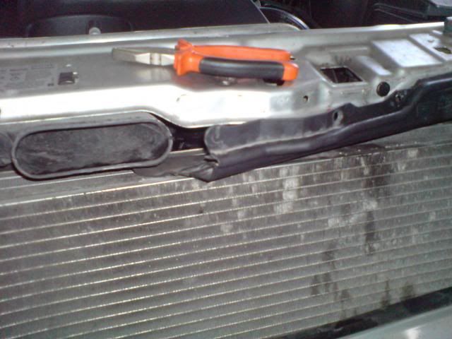

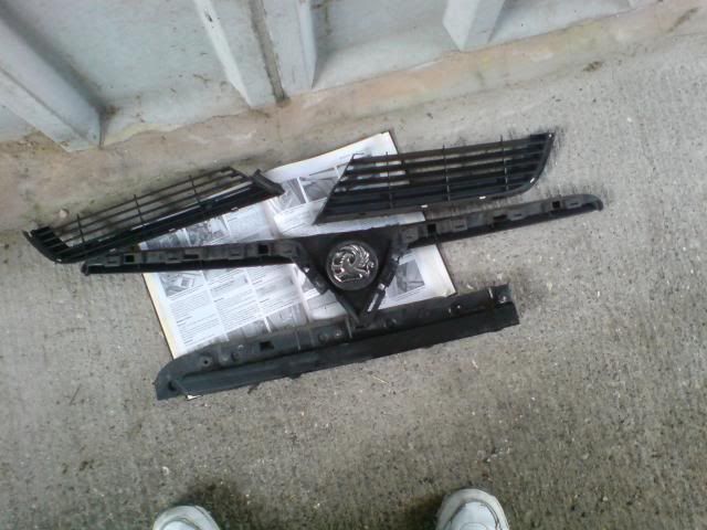

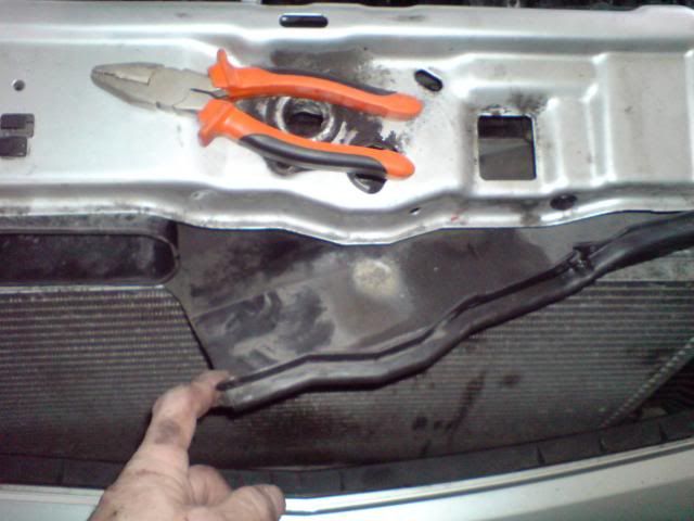

    Managed to get the ****** thing opened today........ had to bite the bullet & rip out the front grill. Had to also fiddle about to remove the plastic channel that covers the air intake duct and also remove 2 of the plastic rivets that hold on the plastic strip at the drivers side so that i could bend it out of the way to get me fingers in. Used a coat hanger to loop around the spring eye & a good tug opened it.
    Here are some pics in case it helps some unfortunate soul in the future.
    These 3 pics show the drivers side plastic strip partially removed to allow it to be bent out of the way to allow access.
    2 of the holes in the plastic strip where the plastic rivets need to be removed.
    Me poor grill in 4 pieces and the air intake plastic shield.
    Grill bodged for time being & cable tied on.

    As far as repairing the grill, i was pushed for time as i had to pick the grandson up from school....hence the cable ties. But i reckon, with more time to spare, i could repair it well enough with glass fibre to avoid buying a new one. I priced a new grill from my local dealer.......£69 + vat!!. No chance.
    @V6VC.....once the grill is out of the way, the fiddly part is removing the plastic rivets from the plastic panel on the passenger side. There is a total of 3 (IIRC) plastic rivets but i could only get at 2 of them. The one on the passenger side i couldnt even see, but with the 2 removed it will bend easily enough to allow you to get a hook in to pull the spring catch.
    What did confuse me initially was the plastic channel on the drivers side.....the one that covers the engine air intake. I thought at first that it was attached to the slam panel, but it is fastened to the grill itself. when you rip the grill out you will see that it is attached to it. It is at this side where you will need to put your hand in to enable you to feel the spring loop......then you put your wire hook in at the passenger side (where you have the bent plastic panel)then feel with your left hand to engage the hook onto the spring loop. Give it a good yank & you are in!
    You need to take care when bending the passenger side plastic panel to not damage the air con condenser......so long as you take your time & dont loose your rag with it you will be ok. Also a good idea to put some strips of masking tape along the bonnet edge where it meets the grill so that,when you are ripping the grill off, it will protect the paintwork when levering with a big screwdriver.
