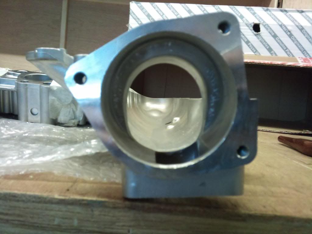

    new to the site guys and would like to share my findings with what ive done it may or may not have been done but here goes.
    new manifold was ordered and when i received it i unscrewed it and split it open and removed all the egr fins in the end and opened the apperature in the throttle body end were i could.
    as you can see from the picture what ive taken away, i cleaned it down and fitted it back together with a loctite sealant from halfrods 5610 i think if ya want to know ill find out for you.
    i used the how too off this site (thankyou very much) took me four hours to replace the manifold and its been on the car a week now and what an improvment over stock, i have fully blanked the egr with a full plate and just refitted that back on also swirl flaps are still in.#
    the car is now a different car again its like ive been back to the tuners for another remap.
    inlet manifold = restriction.

    certainly no more lag exactly the opposite for me my car drives miles better now and more responsive

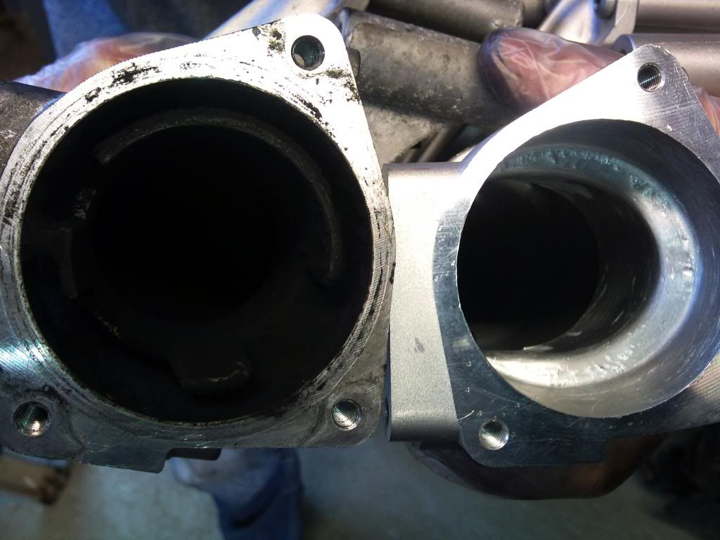

    How bad was the last manifold though?
    Mar 2013
    hull
    Vehicle : astra
    Trim : sri
    Engine : 1.9cdti 193bhp
    this bad

    Do you have any more pictures?
    Also did you smooth the internals of the inlet manifold or even 'port match' them?

    Pics of what exactly chaps come on chaps be specific...
    The main bits i did was to the throttle body end and all i did to the ports was smooth off and anfuler surfaces and msde them more smooth.
