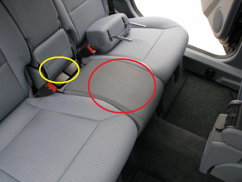

    Here's my Signum, with the non-standard middle seat. The section circled in red is the bit that I can remove easilly. Maybe Haynes is correct and it's actually under the bit circled in yellow?

    i done it easy and pm sent lol tank down best bet the seat job is a waste of time asthe pump is in there nice and tight plus you need alot of room to do ittank down for anyone thinking of doin this

    do i need to drain the tank to do this? I was just thinking of removing the seats to save labour when it goes in for the upgrade, I cannot run with the new pump yet, all the other bits (TD04HL16T turbo and 630cc injectors) need to be done at the same time and the new map applied otherwise it will overfuel badly. But if its a tank out job at least I can advise them of that to save them wasting time/labour and i can leave my seats in.
    Jezzy I reckon the access panel could be there as circled in yellow, not keen in taking it all out though if dropping the tank is quicker/easier.
