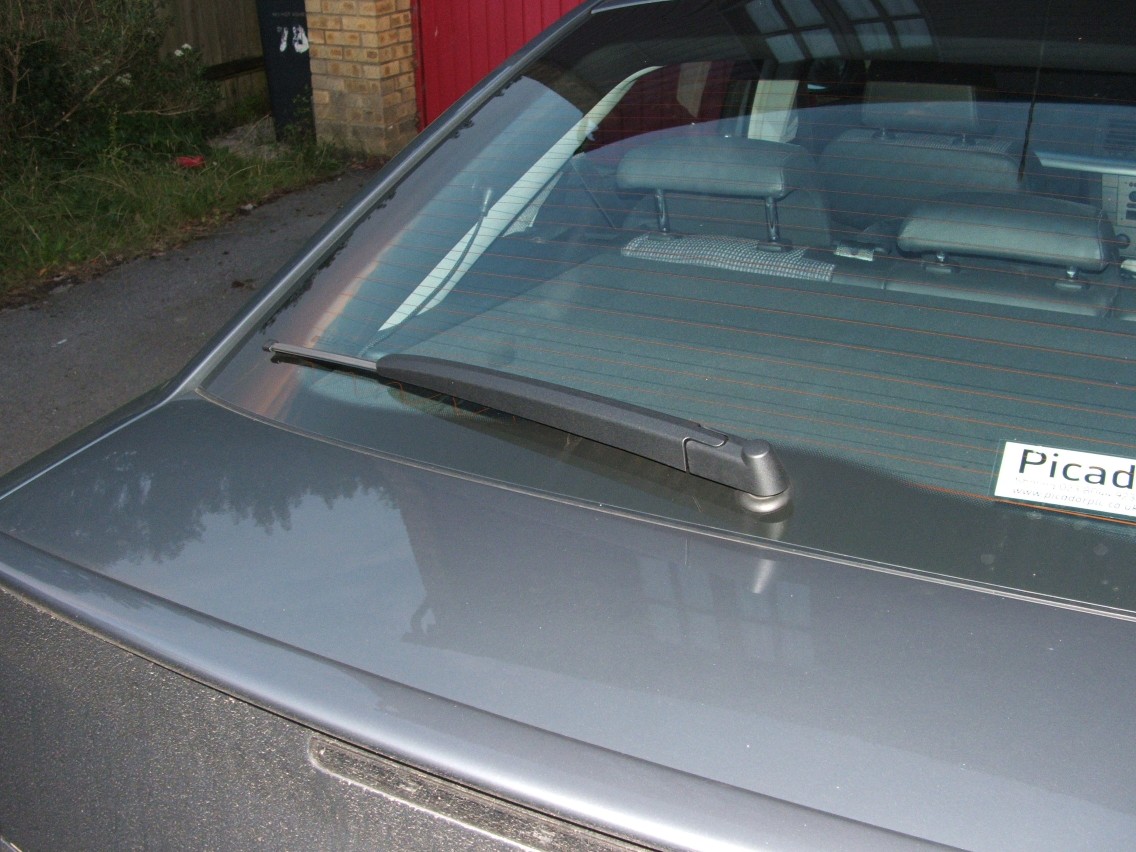

    Smile Picture of New Rear Arm
    Here's the arm and blade picture fitted to my vectra;
