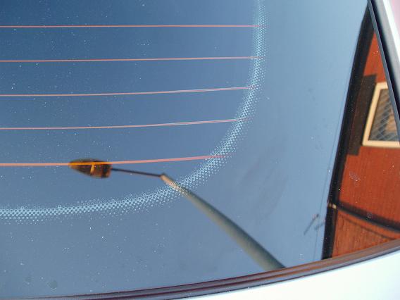

    My only advice is to watch the dot matrix for the rear demister on the rear screen. The tints do not completely obscure these. So if you're having 5% on the rear the matrix will really show up. I'll take a picture of mine in a minute to show you. Ask your fitters what they do with the dot matrix?
    Alex
    Here yer go mate -
    He mentioned that, without me asking (as I wasn't aware), that you could get a bit of light showing through.He gave it a terminology that I can't remember. A pic would be really cool mate as I couldn't totally visualise what he was describing.

    Ah cheers Alex - you were quick!!! Just about to go and look at my car to see how it may affect me......

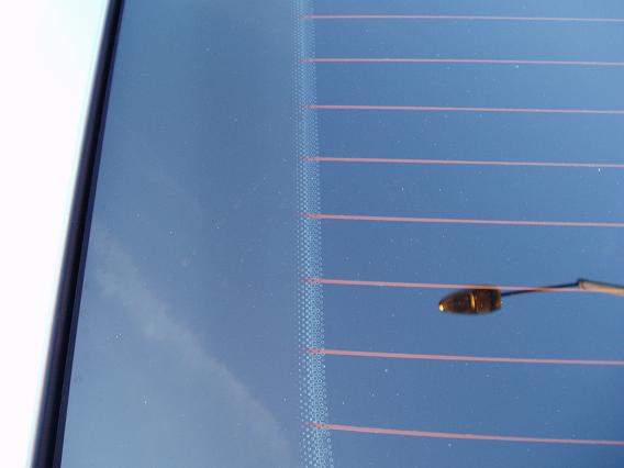

    Just had a look at mine. From the inside of the rear screen, there is still a visible black 'border' between the dots and the edge of the window. I'm assuming that they can therefore overlap the film onto the border so that I get no bits of light coming through?
    Yours, I assume, is different? Do your dots go right to the edge of the window when you look from the inside?
    Here's a pic to show what I mean on mine...
