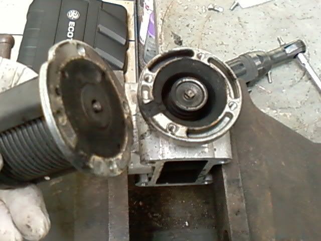

    just a couple of pictures of valve when removed note the soot build up!
    http://i187.photobucket.com/albums/x...8/SP_A0276.jpg
    seperate the valve by undoing 4xtorx bolts
    http://i187.photobucket.com/albums/x...8/SP_A0277.jpg
    http://i187.photobucket.com/albums/x...8/SP_A0278.jpg
    http://i187.photobucket.com/albums/x...8/SP_A0279.jpg
    look how bad this looks!

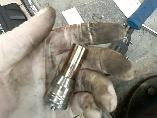

    gently tap punch through hole until the solenoid insides come out next pic
    http://i187.photobucket.com/albums/x...8/SP_A0282.jpg
    http://i187.photobucket.com/albums/x...8/SP_A0283.jpg
    http://i187.photobucket.com/albums/x...8/SP_A0284.jpg
    what you should have when you have tapped out insides of solenoid now you will see the real cause for the egr complaint these parts will be corroded and cause sticking, believe it or not its not the soot that jams the valve but this corrosion

    clean up removed solenoid parts, i use a bench wheel, and reassemble in reverse of removal but lubricate all parts with a touch of grease or the like.
