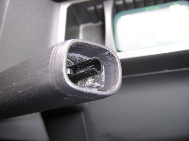

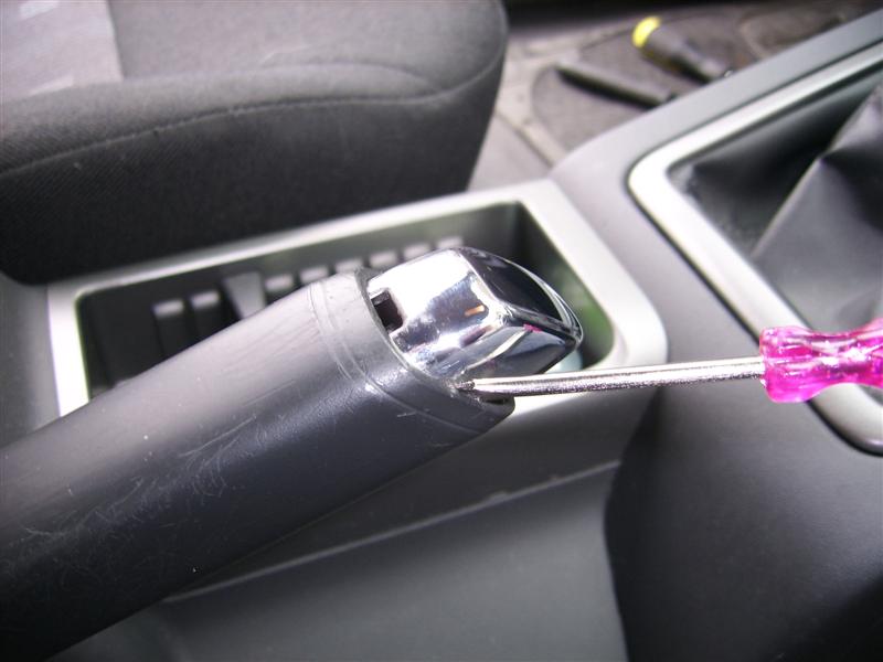

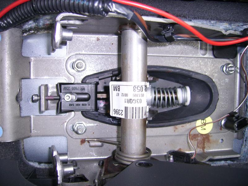

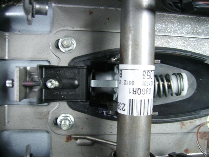

    I got the rear centre console removed to check the operation of the self/auto handbrake adjustment in line with the Haynes Manual information and took some pictures of what was underneath.
    Looks like some kind of adjustment is possible in these pictures...does anybody know if the brown coloured hexagonal rod is actually the operating rod that connects with the handbrake cable under the car???
    Any comments will be much appreciated....
    I also planned to strip off the handbrake lever trim...ie release button, grip and lower plastic trim panel, to check the replacement spring fitted by our local Vx dealer Bristol Street motors 18 months ago as part of the recall. I removed the release button OK , but have struggled with the grip and lower plastic trim , which I assume must have been removed to fit the replacement spring kit by the dealership. They couldn't get to it otherwise, I also took some pictures of where I got to.....highlighting the pivots which seem to prevent the trim & grip sliding forward to reveal what's underneath.....
    p
    Again any comments on removing the plastic lower trim pivots would be appreciated, after all the VXl teckies apparently change the relase button spring in 20 minutes or less so we are told, so they can't be stripping out the complete handbrake assembly in that tim...can they?????
    hope they are of interest to some of you with Handbrake isssues....

    No comments on the pictures I posted showing what looked like some sort of adjustment mechanism, what it did or was for, or that some sort of manual adjustment might be possible...only that it cannot be manually adjusted...

    Hi James.. the picture below highlights the mechanism I on about..
    Seems to have facilities for adjustment of some sort...what?????

    A very good question - I noticed that as well but it doesn't seem to be mentioned by Haynes or Vauxhall.
    I think the auto-adjust mechanism is part of the mechanism that sits in the black plastic recess in the middle of your picture and disappears under the floor.
