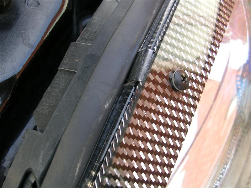

    got the head light protectors and think know where they go but,not 100% on the fixing bracket position.seems VERY close to bonnet.
    any one got any pics of them up close with bonnet up,more the fixing than anything.
    thanks in advance
    hi,
    i have these fitted, the bracket slips under the rubber seal on the top of the headlight,
    i will pop out n get a pic if you want
    BB

    under the seal that sounds better
    a pic would be greatly appreciated if u have 2 mins to sort one
    there you go,
    hope these help
    one small tip, if you find the outer edge sticks up more than you think it should, slide the bracket a few mm's towards the wings , this will have the effect of pulling down the edges
    good luck
    BB

    champion
    thankyou very much
    a job for tomorrow or saturday and a small one at that.can`t do it now honking down,thunder etc
    well i never i put mine on top of the rubber.you learn something new every day

    yep me too..put mine over the top..no wonder it was very close...
    just been out and put it right.iam glad iam not the only one.

    job done..much better now!..learn sommat new every day!...
