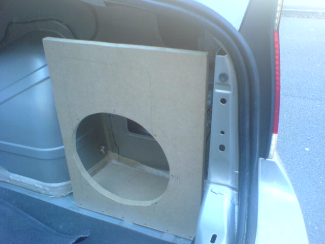

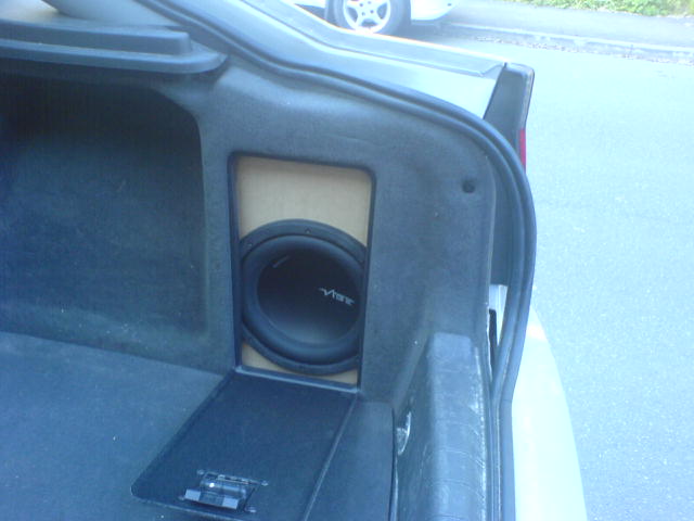

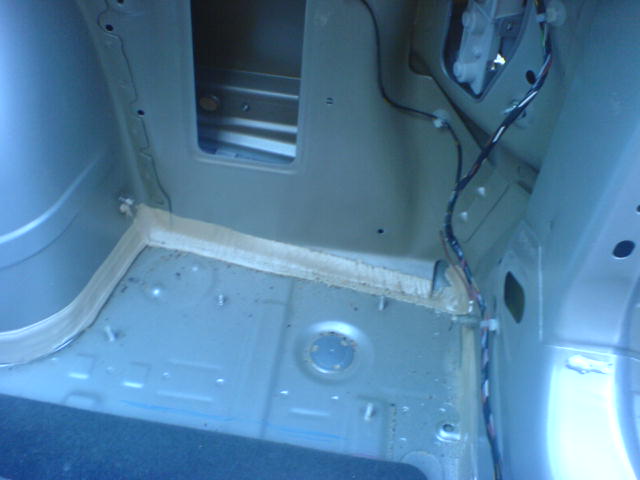

    Loads of room behind the right hand side.
    I fitted a baffle only set up but it was pants, using a sub and amp from an old Vibe active system. Think you just need to build the box, then go to any decant audio shop with the internal volume of the box and they will give you the correct sub.

    looks nice whats it sound like ?

    Looks mint.
    I would love to doo this also.
