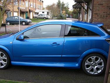

    vxr and snowflakes are different wheels.........and yes both types come in 18s as well as 19s......and yes a straight swop over...
    i like both ..but have the snowflakes 19s......think gregg was selling some 18s snowflakes

    You can get snowflakes in 18" (standard VXR alloys) and 19" (optional XP alloys) - the 19" VXR wheels are different, they are like BK999 alloys, like this:

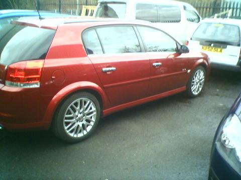

    The 18" multi-spokes are what I have (check my profile), they are optional on Vectra Elites (I think) and come on Signums and the new Astra twin tops too, these don't come in 19".

    my car is a 04 design,these are the multi spoke design 18" wheels that was an option
