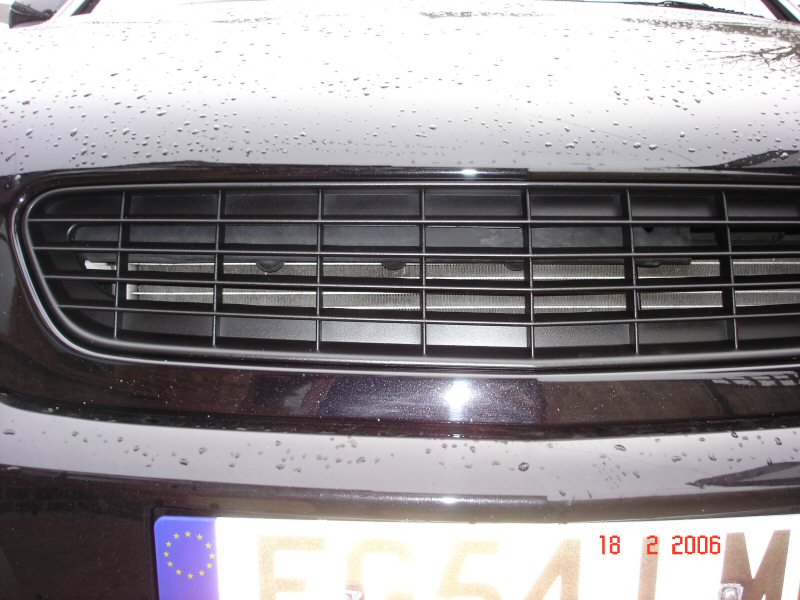

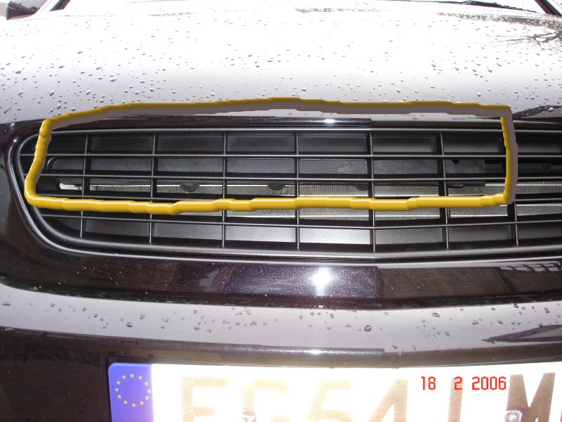

    As you look at your grill there is this,sat behind it,protruding down and 3/4 along the grill left to right as you look at it -
    Which looks like this behind the grill -

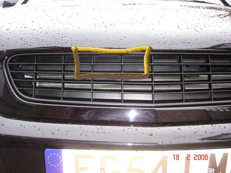

    Which is here in the yellow box -

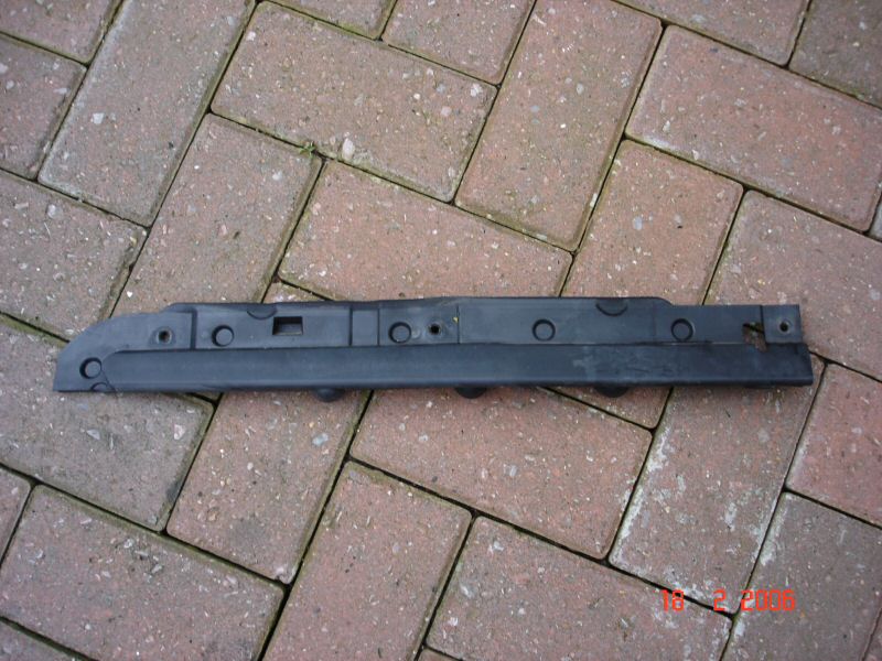

    I only really noticed it when I replaced my grill today.It`s designed to come off,because it comes away when you remove your grill and it`s secured by the grill fixings.
    It covers the air intake which is sat about here -
    I can only think that its there,for restriction OR to protect the intake itself.As there would be nothing at all to stop anything going up the intake,if its removed.
    The part completely covers the intake.
    So how about drilling a few holes where the in take is,say with a 6 mm bit,so it aids airflow,but still gives some protection.
    If you put some masking tape on and mark the location of the intake,then remove the part and drill the holes (only 3 screws) it would save any damage to your car.
    Any thoughts or ideas on this?
