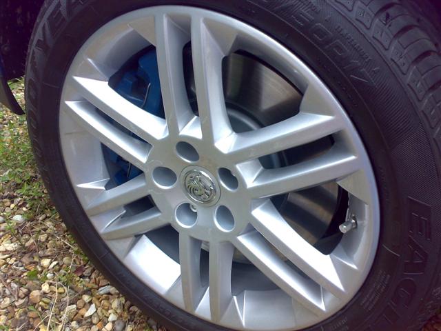

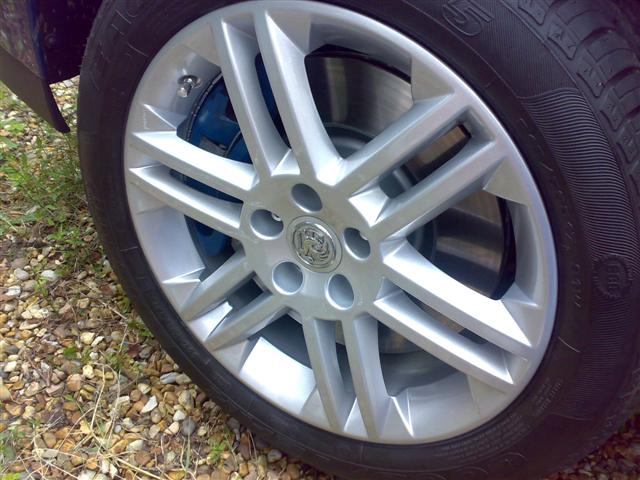

    Quote Originally Posted by mark1319 View Post
    Well 345's are whats on the Plod cars and they run 17's, but obviously if they are made to fit the 345's inside them. I asked a guy and got a pic of them inside the 17's. will grab the pic
    the 345's also fit under the pre-face 17's twin-spokes and clear the balance weights

    Ferk, they look ace in SRi rims, totaly fill them up.
  8. #88
    May 2008
    UK
    Quote Originally Posted by rushy View Post
    yeah not alot of clearence but works!
