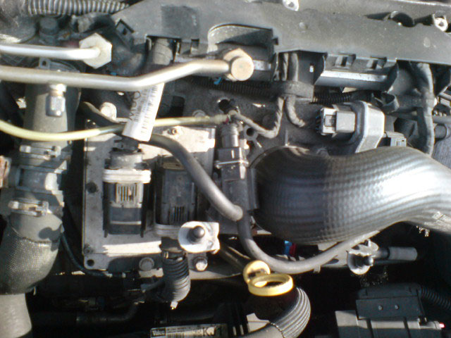

    i have a pic its not very good could some plz send me a pic of were it should be from
    I can't quite make out where you've got that as it's so dark, but I think you've got it kinda in the right place but possibly on the wrong side of the solenoid, hence why it's snapping back to zero all the time.
    Here's where I tapped off.....
    Hope you can see where I'm meaning from the pics - quick snaps on phone.
