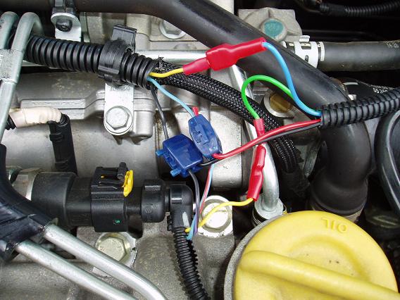

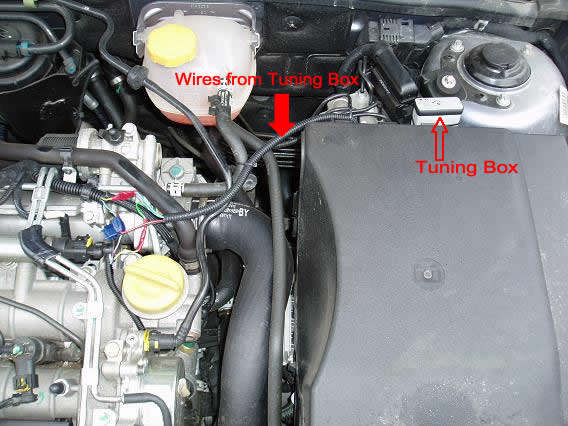

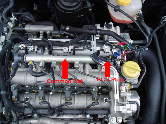

    Pictures of install -
    The only wire that was cut was the yellow one from the ECU. The blue wire from the Tuning Box was attached the yellow wire from the ECU; the Green wire from the Tuning Box was attached to the yellow wire going to the Plug. The other wires were attached to the uncut wires from ECU via the blue connectors as shown below.
    To remove the box completely (should you need to do so) you just simply unattach all the wires and join the yellow ECU wire back up and you'll be back with the Vx setup. Easy
