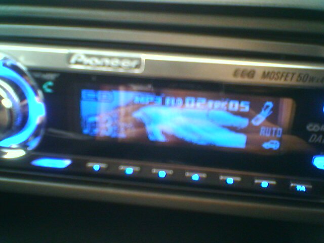

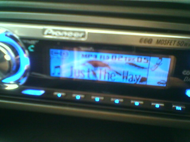

    For you guys that have one of these do you know why my display keeps flicking from this
    To this
    Sorry for the quality, it's off my mobile.
    I hope you can see that it seems to flash so the whole screen is blue, as per second picture (more obvious on the right of the display). It's natural state should be the first picture.
    It does not matter what background or movie I have on or even have the entertainment turned off altogether it still does it
    Any ideas
    Cheers
    It second pic looks like the negative of the first one. It must be a setting somewhere.

    This used to happen on my DEH P7900... if you turn it off (with the ignition on) and press and hold preset button 3 or 4 (can't remember which and it may be different for the 70BT) it should stop it doing this. You should hear a beep when it has done it.

    Worked it out, partially thanks to AJA.
    With the stereo turned off but with engine on the date and time is shown on the screen.
    Push and hold the multi control button to pop up the menu. Scroll round the menu and there is an option called 'REVERSE'. Turn this feature off and it solved the problem.
