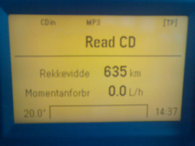

    After loading a mp3-disc (made by me), the displays shows "Read CD" for minutes. Usually it gives up, and the radiostation is taking over.
    Also: When I try to unload the mp3-disc, it seems that this task is demanding to long time, so the radiostation is (here also) taking over (and the disc stays inside).

    Below you can see what the display looks like. :confused:

    Try burning them at lower speeds and don't use CD-RW's
    It takes some time to load, but minutes is to long. It depends of the number of files and/or folders.
    Have you tried a disc with only 2 or three files on it to test it? Other brands of CD-R's?
