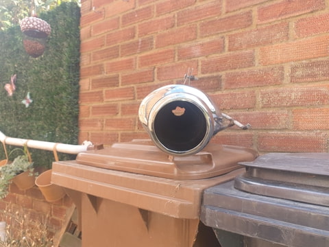

    well it has been solid again and trust worthy... so the love is slowly coming back... i might still pull out my fingers and put on that aftermarket rear exhaustbox...if you are wondering what it looks like...see the picture below
    not only is it a straight true exhaustbox it's made by Cherrybomb... so once it's on it'll be noticeably audible( read deep base note) the oem rear exhaustbox literally dampens all the good noises so yeah i'm kinda looking forward to put it on jut need one more pipe as the oem one has a corner mounted 45 degree bend down before connecting to the mid section and somehow i can't find the right diameter 55mm OD.. 45 degree pipe ( they are either to small or to big... seems like i'm going to have to go to an exhaust specialist just for that one pipe... and the Cherrybomb box has a centered rear inlet so the replacement 45 degree pipe needs some extra length too...

    Is that real stainless steel alloy? Having a empty pipe will it pass the mot because of the noise? I wanted to do it myself but the exhause is very noisi and i doubt i will pass mpt in romania. Reason? It’s starting to rust A LOT
