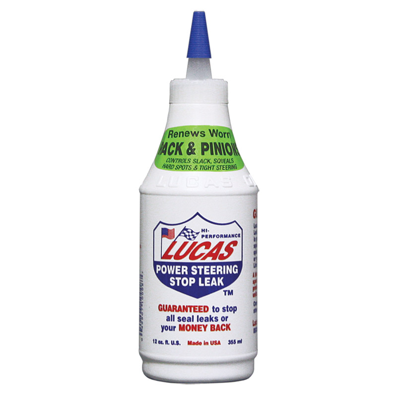

    yesterday I removed the fresh powersteering fluid, because it howled like a banshee after it was replaced with fresh vauxhall specific powersteering fluid. when i removed the old oil it was filthy and gritty... and thought that the new oil would be better... well when i removed it it was nasty black but not gritty anymore... so i filled it up with this
    and topped it up with some fresh vauxhall specific powersteering fluid...
    low and behold the whine reduced to almost nothing after a drive, it occasinally would be there but not as loud a it used to be... enter this morning when i had to drop someone of at work in the ****** early hours, well long story short the whine has seemed to have disappeared completely. it was a good old 30 mile drive. But even when the wheel is turned to full lock either side no more whines, low pitched or high pitched. result!
    so to the other people that have a whine coming from the EHPS, i suggest you do as i did, replace it for a few weeks, than drop it and add the lucas first and top it up with the vauxhall specific powersteering fluid, as i almost went and replaced the darn thing... this was a cheap tester to make sure it needed a replacement before getting the replacement pump that would cost me an arm and a leg...yeah the one that is mounted in front of the OS front wheel-well instead of the steering rack is seriously expensive, so much that it would warrant me getting rid and replacing the whole car, not that i would with all the parts i recently replaced.
