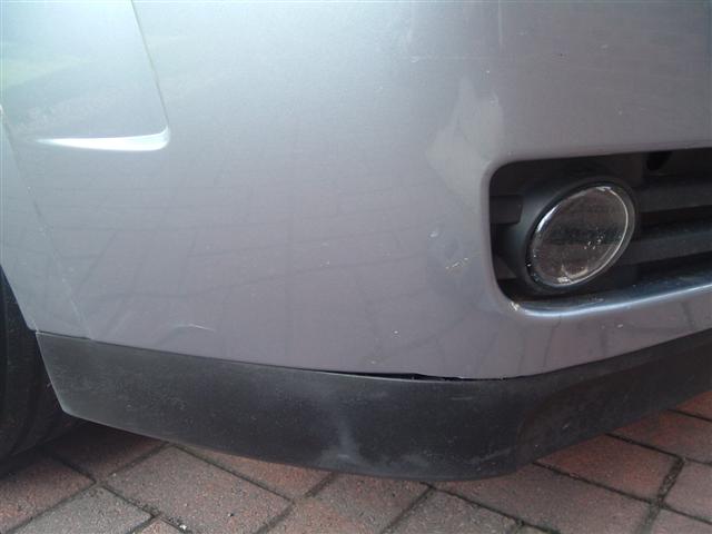

    Upshot is I've cracked the offside of the front bumper, but it's not something you'd notice. However, the offside spotlamp mounting is broken and the lamp is now not attached to anything. Also, having never looked underneath the car. I'm not sure if I'm missing an undertray. (I can see right up into the engine bay)

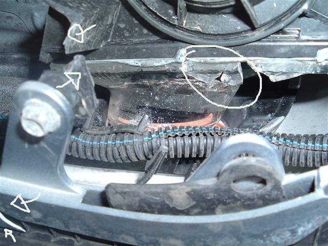

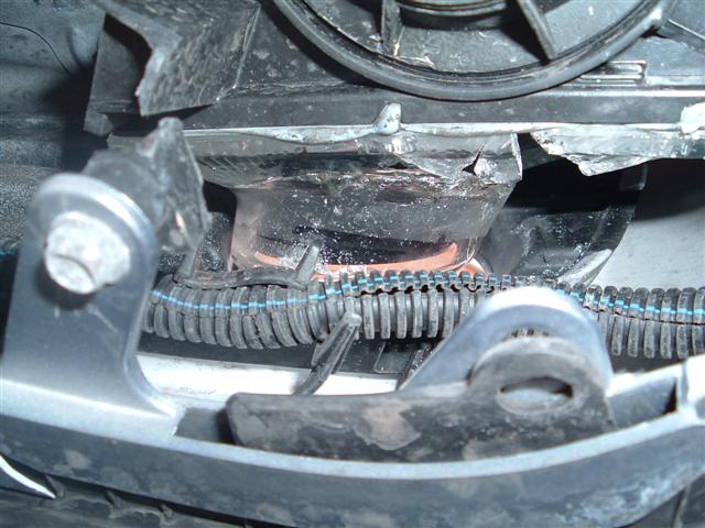

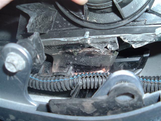

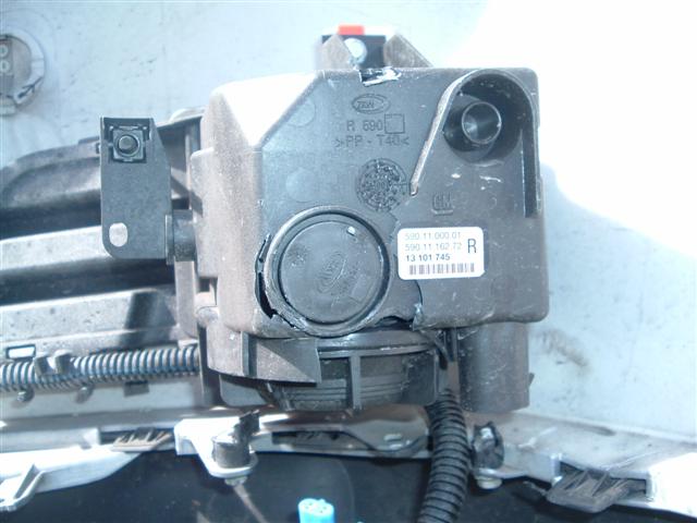

    As you can see (I hope) the two bottom brackets are sheared off and the light smashed. The top of the spot is held on by something. It's so difficult to get at and I can't tell if it's a nut, screw or just a popper. Any of you guys who have had the bumper off got any idea.!!

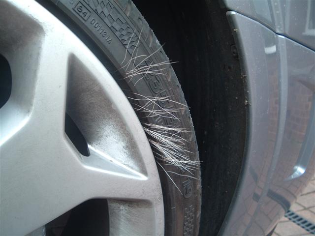

    Doesn`t look to serious mate, and the hair on the wheel must have put a wry smile on your face, I reckon it will easily repair, I have had my bumper off, the only screws are the ones on the inner wheelarch, all the rest are poppet type things . I don`t recognise the bits in the pohotos but maybe mine is different with the splitter on ?
    Regular Member MLC's Avatar
    uk
    Took those lying on my back looking up at the spot. The spot is being pulled backwards slightly. The two arrowed points should be connected.
    There is another broken mounting to the right and the bottom arrows is where the bumper is split

    Dont think hairy tyres will catch on some how, do not take it to vauxhall matey unless you want to use your overdraft up as well

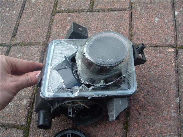

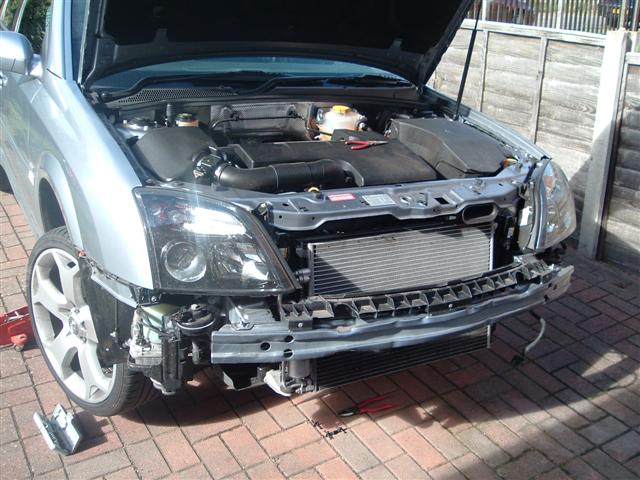

    Well, thought what the hell and took the bumper off. (Thanks to the 'How to' guide).
    I've got the destroyed spot out. Glued the split and my finger to the bumper!!
    Just gotta put it back on now. If I was sensible, I'd have waited till I got a replacement spot.......but these things really bug you don't they!!
