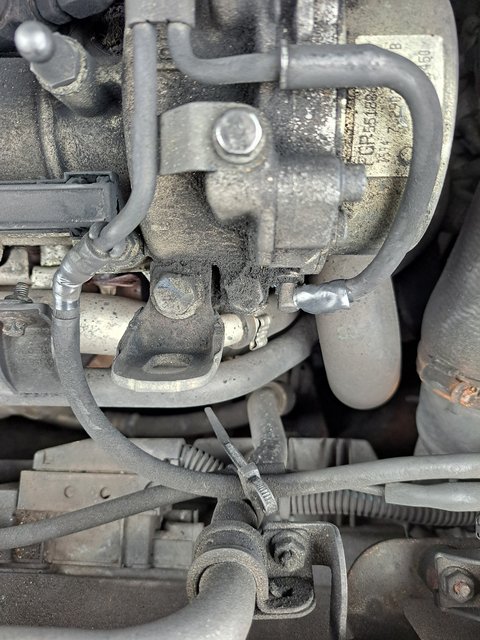

    I brought my Vectra back from the brink.
    I know that sounds very dramatic, but when your MOT smoke test is more than double the prescribed limit.
    Limit is 3.00, and our 1.9CDTi 150 was kicking out 6.52!!
    The dual mass flywheel is also on it's way out, so no chance of risking rpm surges when using 10k / Lucas inlet manifold cleaner up the intake trunking.
    I really struggled to decide what to do, when finances aren't really on my side. Maybe time to scrap the vectra - yeesh.
    Eventually I wobbled my brain cells-
    Plan was to clean the inlet manifold, (Decoke)
    but it is always best to start at the EGR valve first with these crappy Fiat derived CDTi engines.
    I also cleaned the turbo-boost sensor.
    The EGR is only about 12 months old, so not very dirty.
    But still got a quick blast of carb cleaner and wiped out.
    The boost sensor was absolutely clogged, so carb cleaner to the rescue.
    Anyway - was going to wrap up for the morning, when I discovered two cracked / split vacuum pipes from the turbo vacuum sensor.
    Temporary fix with pvc tape. Not brilliant but it helped.
    It was pretty hard to find anywhere that sold 3mm vacuum tubing. Even the big guys like GSF, ECP and Halfords were unable to help.
    After about ten calls to motor factors in a 15 mile radius from here, I found a tiny random shop that had 3mm bore hose on a roll.
    1m for £2... cannot grumble.
    What I didn't know was that both pipes had a 3mm stub at one end 5mm at the other - oh poo!
    Warmed one end of each hose, and slipped them on... with a bit of effort.
    Put everything back together....
    Set the phone video camera running, and video'd the exhaust whilst I revved the tonkers out of the car.
    Variabled periods over a minute of revving between 1000 and 4000 revs did not produce any plumes of smoke.
    And the car is now really responsive and perky.
    So I am much more relaxed now, after stressing for the past few days.
