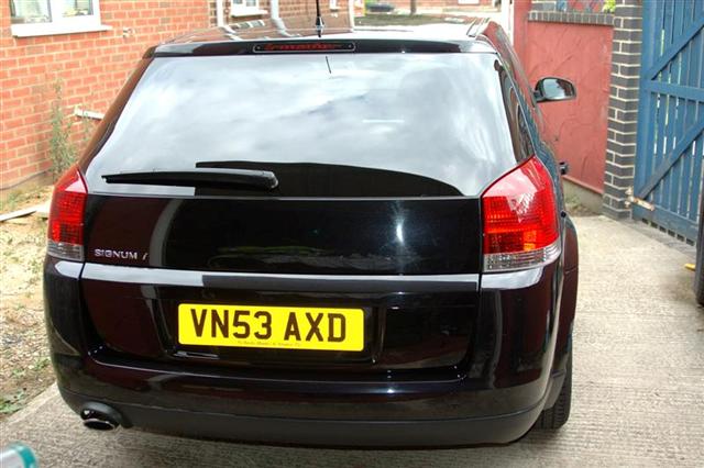

    i had a similar mark on mine when i removed the rear griffin,
    i bought a tube of ' hand rubbing compound ' from halfords for a few quid, got a soft cotton cloth and proceded to cut the paint on and around the dull part, this will take the paint ( solid or metalic ) back to a good base,
    then use a good quality polish/wax to make her shine like new again, took about 20 mins in my case,
    the beauty is that the rubbing compound can be used anywhere on the cars paint to remove small scratches in the laquer etc, then just polish it up
    this process is known as ' mopping ' in a pro paint shop, i know this cuz my two brothers paint cars for a living
    as shown below
    i did this within 24 hours of getting my new car, lol
    hope this helps
