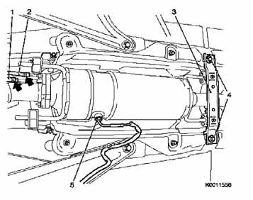

    Question to the 1.9CDTi owners, please can you have a look under your car and confirm whether you have the bracket listed as item #3 on the attached diagram (It is attached across the aluminium heat shield to support the catalyst cross member in the event of separation or corrosion)
    Reason for asking, my 1.9CDTi does not have it (or no longer has it )

    Had a look on mine and cant see the bracket mines a Z19DT hth.
    Leicester
    I have the 1.9 DTH (150 16v). Mine does not have this bracket fitted.
    Now if I remember correctly, this bracket has something to do with an extra particle filter as fitted to Signum and Vectra Estate models with the longer wheel base. I am sure this has something to do with it.
    This is why Signum and Vectra Estate models don't have the 30,000 service intervals, I beleive they need an oil change half way.
    Don't quoet me on this but I am sure this part of the reason some have this bracket and some don't.

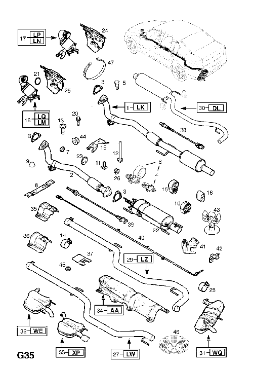

    I thought most Z19 DT and Z19DTH are Euro 4 compliant ... this meaning that they have a particle filter fitted ....
    The particle filter is item number 22, and bracket is now number 8.

    Hope the attachements are useful .... picture paints a thousand words and all that ...
