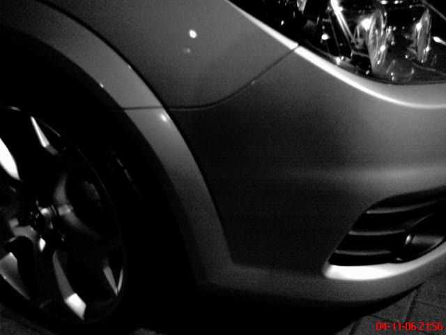

    My colour match is spot on ..... did have to go in a field to get it done ....
    But saying that it was fine beforehand as well

    Very nice ! The main bone of contention regarding colour matched paint is the variation that can be seen on the majority of Facelift models....You can look at two indentical models (type and yr) and one will match but the other looks awfull...+ some of the bumpers fit fine......others have gaps upto 10mm between the bumper and headlight unit.on both near and offsides...The production & assembly quality control seems to have taken a downhill slide for some reason in both accumulative geometric assembly error and paintwork matching??
