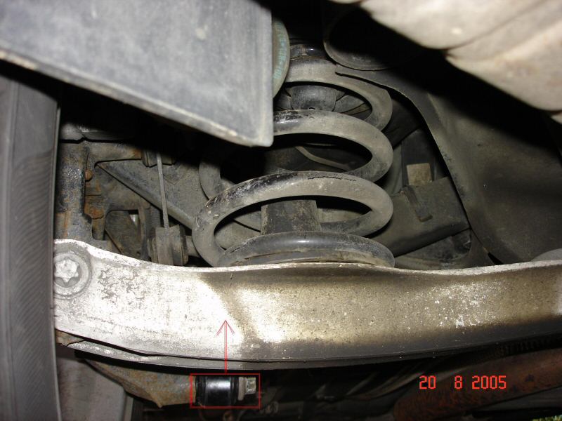

    Here`s my suspension the `spring` is totally seperate to the `shock` which you can see the base of at bottom of pic.I`ve had new new rear `shocks` today.Hence my question.Want to triple check it`s done right.Now people are saying the above.
    So are springs now called shocks and shocks called dampers?
    Cos I`m confused if thats the case.Why?
    i was just being pedantic m8,
    your spring is the shock absorber in the system, and the damper stops it from moving to many times giving it a bouncy ride,
    but as much as a vacume is a hoover, a spring is a spring and a shock is what you mean
    BB
    Leicester
    Although what 'Brake Buster' is saying is technically correct,
    The general abreviation is that the terms 'dampers' and 'shocks or shock absorbers' are the same item and springs are the other item.
