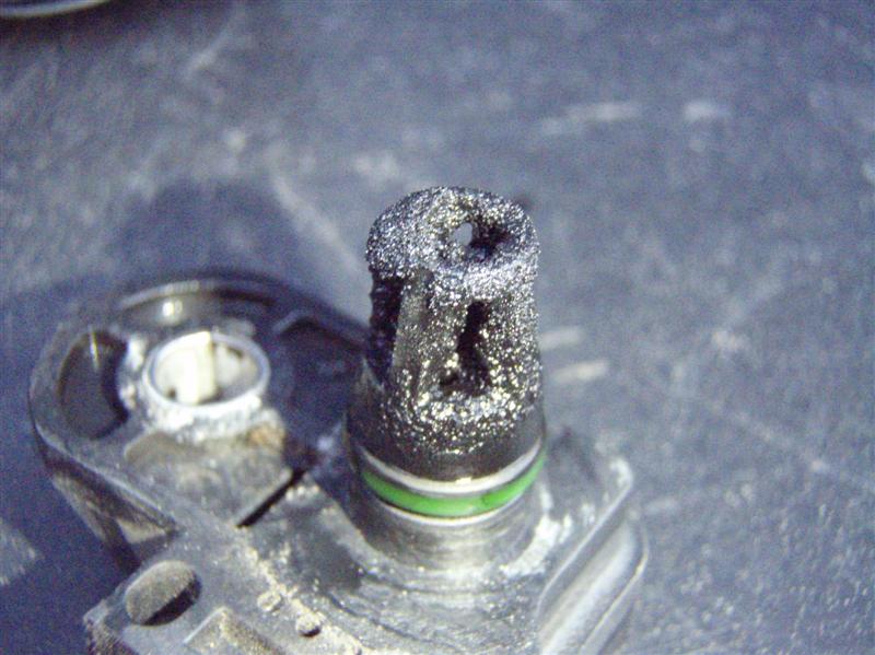

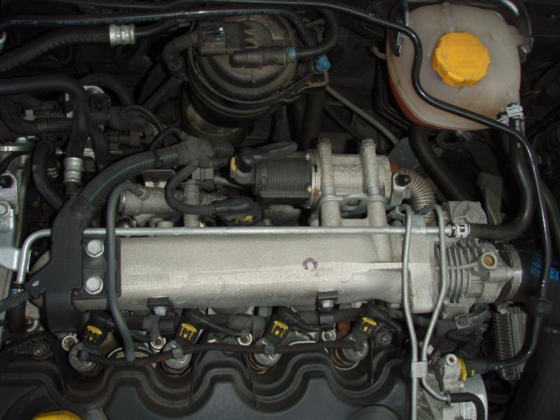

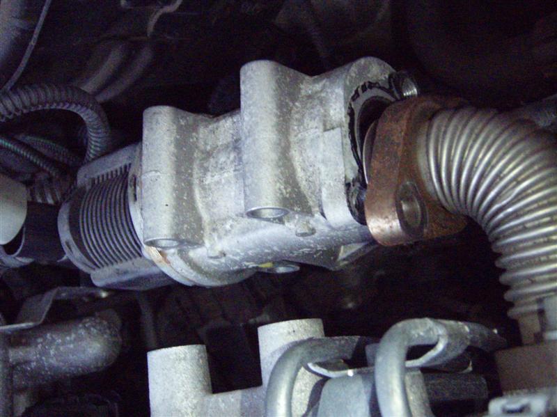

    HHmmm Tried to remove the EGR tonight before it went dark..FAIL.
    Couldn't budge the allen screws holding the bottom hose on. the one comming from the bottom of the engine into the underside of the EGR. I noticed a Jubilee (?) style clamp on the other end of the hose....I was tempted but HMMm This was all I could get off.
    Don't really want to trash the bolts and then have to go to the garage.....Still, I got the boost sensor off and gave it a clean. Seams to have made a small difference in the turbo pick-up.
    Regular Member barney490's Avatar
    Dec 2009
    PRESTON
    the two bolts holding the pipe to the underside of the egr are as i recall torx bolts, not allen key head. Make sure you use the right torx socket as an allen key socket will very likely knacker the bolts. It is normal procedure to remove these rather than the clamp further down the pipe at the egr cooler, but if you must remove that clamp, be careful to catch the circular gasket that is in there,a s these cannot be bought seperately.
