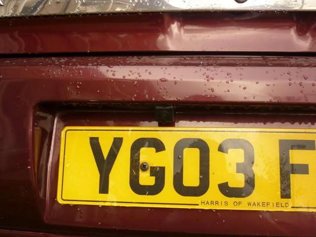

    show me yours.
    where did you fit it (obviously at the rear)
    just got one from the bay and just need to know the best place to fit it

    heres a couple of links to mine matey, a bit too much work envolved for some though....
    Link
    Link
    HTH

    I bought mine from ebay, closest match to mine is this one -
    http://cgi.ebay.co.uk/Reverse-Rear-V...item20b3b3cec0
    Regular Member elite lee's Avatar
    May 2010
    torquay
    Quote Originally Posted by dazzy2006 View Post
    i bought mine from ebay, closest match to mine is this one -
    http://cgi.ebay.co.uk/reverse-rear-v...item20b3b3cec0
    thats perfect, how was the wiring done. Ie easy job or not
    Regular Member Dazzy2006's Avatar
    Dec 2009
    Notts
    Quote Originally Posted by elite lee View Post
    Extremely easy iirc. Camera itself has a built in number plate light so i just replaced the number plate light with the camera
    And as for the wiring - Red wire that goes to reversing light, black wire that goes to earth, And the longest job is fitting the av cable from head unit to back of camera
