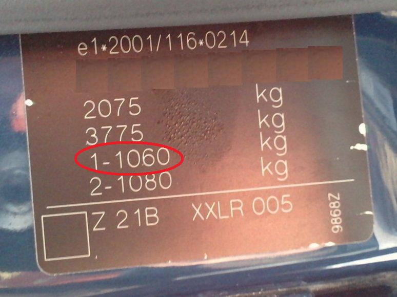

    Mate the 2.0dti is not lower in standard form,the kind off springs you fit will depend on the axle weight which can be found on the drivers side b pillar,have a look on there,then go to Euro car parts for correct spring rating.
    here you go.

    Regular Member macdad's Avatar
    Dec 2007
    East Midlands
    Have a look at this pic borrowed from another thread.. no 1 is front axle..(The one with the red ring)
    http://www.vectra-c.com/forum/upload...010/axley2.JPG
