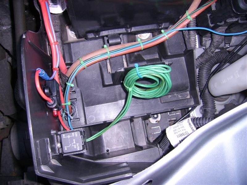

    It was a basic 12 volt relay with 2 x output contacts & Manufactured by PEARL with a reference..PWNPR03.
    It has a common input terminal & 2 x 15amp output terminals plus the two terminals for the operating coil....

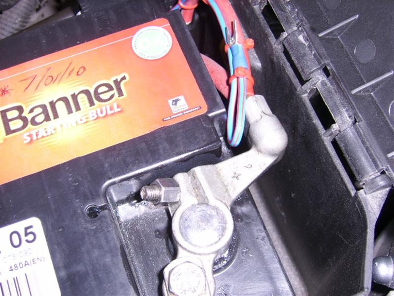

    The photo below shows it in the battery box..partly wired ready for the final connections which due to commitments & weather has not yet been completed...cheers
    Positive terminal with feed to fog lamp 15amp line fuse..
    Fog light relay/15amp protection fuse, wiring etc...

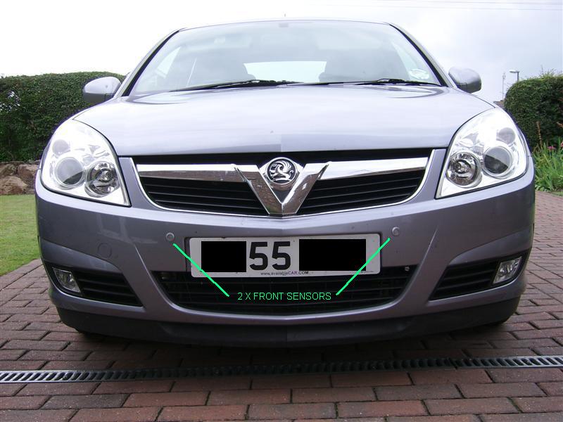

    Lamps fitted into Club non sport front bumper..
