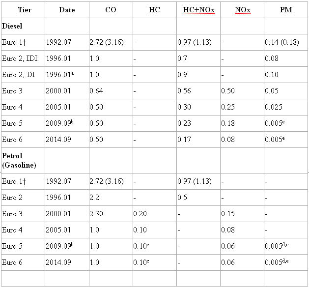

    Emissions are getting stricter (Which is why new cars are less poluting) and as the older cars die it will get better and better.
    Look at the data that cars will have to meet in the future:
    Particulate matter (PM) is the main thing they are trying to get down (Hence DPF's) as thats one of the causes of cancer.
