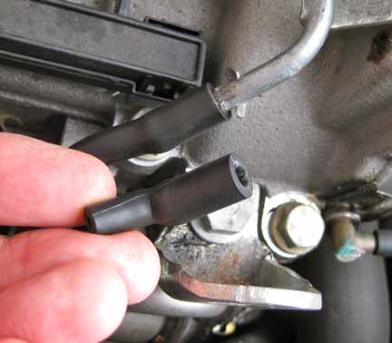

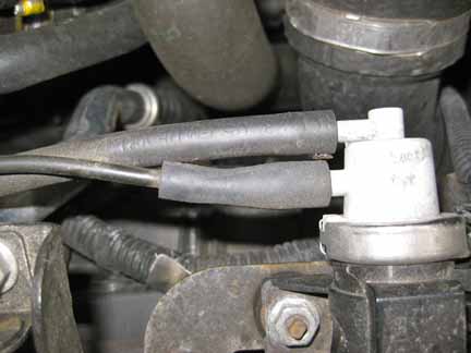

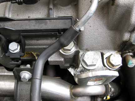

    Took the car to a friendly local company (Elddis Motors, Durham - recommended) rather than the Vauxhall dealer, for a diagnostic. Turns out there was a split vacuum pipe, which I would never have been able to fathom out. I've included some pictures.
    The red circle on the left is where the fix has been done. Originally there was a short rubber section on the metal tube, with a piece of hard plastic pipe between it and the rubber hose (just like the one in the blue circle on the right of the main picture).

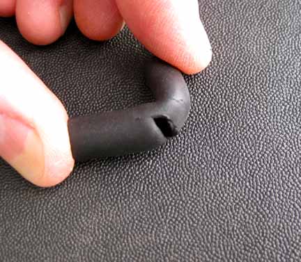

    Anyway, this short rubber section had a split in it, but underneath where it couldn't be seen. You can see in the other pictures how it's perished, probably with the heat, and looks like it's been sucked inwards until it split. This was all going on under the engine cover, out of sight.

    Engine bay with engine cover off. The areas of interest are circled
    Red circled area. The new suction of rubber hose that has been fitted.
    Blue circled area. The short rubber section looked like this originally, with a piece of hard tube going into it.
    This is how it looked when on. You can see the deformation at the bend due to the heat and vacuum.
    The underside looks like this. A small split.......
    But really a gaping hole.
    After replacing this with new tube the car is back to normal, Hurray!
