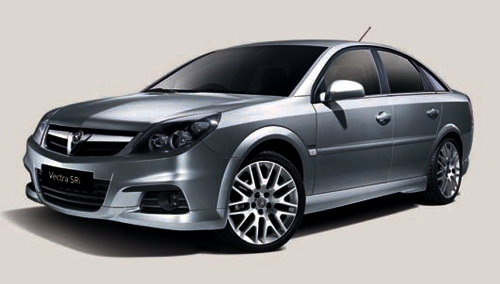

    There seems to be a few people doing the VXR front end conversion, as it can be confusing knowing what parts you need for you car I thought i'd chuck this up..
    Vectra (XP) upto MY2008
    If your car has the same bumper as the car in the pic above you'll probally need these parts:-
    9271527 VXR / XPII FRONT BUMPER (Top Half) (1) (regardless of AFL washers or Parking sensors) £319.00
    9271528 VXR FRONT LOWER SPLITTER (1) £136.00
    9271521 VXR HONEYCOMBE LOWER GRILLE (1) £25.45
    9271523 VXR UPPER HONEYCOMBE GRILLE (1) £24.87
    9271518 VXR O/S FOG LIGHT GRILLE (1) £24.05
    9271517 VXR N/S FOG LIGHT GRILLE (1) £24.05
    93186621 VXR CHROME FOG LIGHT INSERTS (2) £6.67 each
    9270157 VXR FRONT FOG LIGHTS (2) £65.00 es
    9270158 VXR FOG LIGHT WIRING HARNESS (2) £3.20 ea
    9271533 VXR PRIMED V GRILLE (1) £42.30
    9271524 VXR TOWING EYE COVER (1) £30.00 ('ISH)
    93160447
    PARK PILOT FIXING KIT (if you have front parking sensors) £13.62
    24449408 NUT CLAMP (6) £0.60p
    90450482 FIXING (4) £0.84p
    90087290 RIVET (4) £0.52p
    90508809 RIVET (4) £0.48
    90138810 RIVET (30) £5.40
    Vectra (XPII) MY2008
    If your car has the same bumper as the car in the pic above you should only need these:-
    You'll have to check prices as these were from when I done mine some 18+ months ago, just left them in as it may give a rough guide for costing.. If you have upto date prices please add them to this thread..

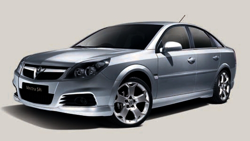

    Grill Kit only, upper & lower grill, 2 x fog light grills, 2 x chrome fog light surrounds , for the Sri Xp option ( the lower picture) Does not include 'v' moulding.
    Archie Moss e-bay shop £156.00 inc vat and del'y.
    If anyone is interested their body shop fitting time is 2.06 hrs.
